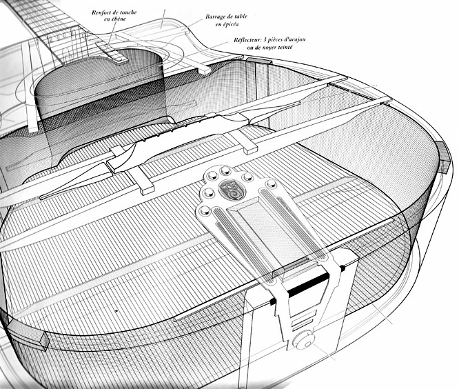

In order to understand that big, authentic sound, it’s helpful to have a sense of the Gypsy-jazz guitar’s history and construction. The instrument was conceived in the early 1930s through a collaboration between the Italian musician and luthier Mario Maccaferri and the French instrument maker Selmer. (Maccaferri later would pioneer the production of plastic archtops and ukuleles.)
The earliest Selmer-Maccaferri guitar was an oddball creature with its large D-shaped soundhole (grande bouche or large mouth); wide, floating bridge; fancy tailpiece; gently arched (not carved) French spruce soundboard; and ladder-braced top and back.
The Selmer-Maccaferri was the first guitar with a cutaway and a steel-reinforced neck. Though the instrument is closely associated with guitar legend Django Reinhardt—and Gypsy jazz in general—it was originally intended for the classical guitarist.
“The first examples were built with [Maccaferri’s] internal resonating chambers to be very present and loud guitars,” says Thomas Davy, the owner of djangoguitars.com, with two showrooms in the Los Angeles area, and a virtuoso Gypsy-jazz guitarist himself.
This type of instrument’s optimal setup differs from that of a regular steel-string.
As opposed to fine steel-string or classical guitars, with solid backs and sides, most of the Gypsy-jazz model Selmer-Maccaferris had laminated Indian rosewood backs and sides—for sonic reasons, and not cost-cutting measures. “The use of laminate was designed to isolate the top,” Davy says. “An arched/bent pliage top and laminated back and sides make the sound reflect outward as much as possible, so the attack of the guitar is quite immediate.”
Maccaferri only worked with the company for 18 months. After he left, his original design saw various modifications, among them the introduction of a smaller oval soundhole (petite bouche or small mouth) and a long scale length of 670mm (26.38 inches). Still, Maccaferri’s name is forever associated with the instrument whose defining sound is characteristic of Gypsy jazz.

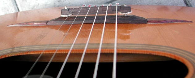

Another surprise comes in the form of playability: This type of instrument’s optimal setup differs from that of a regular steel-string. “The action on a Gypsy-jazz guitar is generally three millimeters above the 12th fret on the low-E string and around 2.8 on the high-E,” noticeably higher than on a standard steel-string, Davy explains. “If you set the action too low without enough tension, like many novices do, the guitar will have no projection or power.”
While you shouldn’t confuse high action with a poor setup, you should know that entry-level Gypsy-jazz guitars often take a bit of work out of the box to ensure the best playability and sound. So if you must order an instrument online, factor the cost of a good setup—generally as much as $200, Davy says. “Many of these import models require fret dressing, adjustment of the bridge feet to properly contact the top, notching the bridge to ensure proper string spacing, and making sure that the tailpiece insert is fitted to ensure that there is no rattle,” he notes.
Something else to consider when auditioning your first Gypsy-jazz guitar: You can’t just slap regular medium phosphor-bronze strings on the instrument. To get the proper sound and tension from a Gypsy-jazz guitar, the best choice is silver-plated copper on a steel core, like Savarez Argentine Gypsy-Jazz Acoustic Guitar Strings.

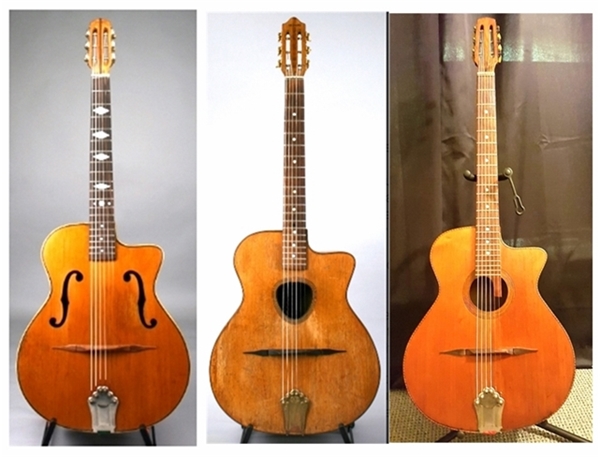

Εκείνα τα χρόνια , στο Παρίσι εργάστηκαν και πρόκοψαν κατασκευάζοντας παραλλαγές του αρχικού μοντέλου της κιθάρας Maccaferri αρκετοί Ιταλοί μετανάστες οργανοποιοί . Μια ενδιαφέρουσα , κατά τη γνώμη μου , περίπτωση είναι αυτή των αδελφών Joseph και Antoine Di Mauro.
Διαφοροποιήθηκαν από το μοντέλο Maccaferri ως προς το μήκος του σώματος , την κλίμακα του οργάνου και έφτιαχναν την πλάτη της κιθάρας με έντονη τοξωτή καμπύλη ( arched ) . Οι κριτικές που διάβασα για αυτές τις κιθάρες είναι πολύ εγκωμιαστικές . Λιγάκι δύσκολο να λένε όλοι ψέματα.

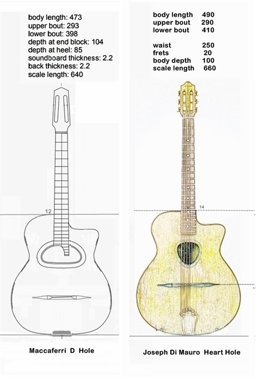

Θεώρησα χρήσιμο να προσθέσω την παρακάτω προσέγγιση - κατασκευή .  Σαν επίλογο ;  σαν τεχνική πρόκληση ; ...
Στην αρχή όταν είδα , είπα , εντάξει , άλλο ένα σύντομο βίντεο για gypsy κιθάρα
https://www.youtube.com/watch?v=7yKkl0V7En4
Οι φωτογραφίες όμως που δείχνει , μου κίνησαν το ενδιαφέρον …
Κάτω από το πλαίσιο , σα λεζάντα , σαν υπόμνημα , μας παραπέμπει εδώ :
http://www.pluckandsqueeze.com/Mac%20project/maccaferri%20project.htm
και αυτό με τη σειρά του παραπέμπει σε σειρές φωτογραφιών με σύντομα αλλά και
εύστοχα σχόλια κατασκευής για κάθε ένα μέρος της κιθάρας.
Μου φάνηκε πολύ καλό . Φιλόπονο και φιλότιμο !
Στη πρώτη κιθάρα που έφτιαξε , τη Mac 1 , το καπάκι το έκανε χωρίς τσάκιση …
Στη δεύτερη , τη Mac 2 , έφτιαξε καπάκι με τσάκιση που την περιγράφει αναλυτικά εδώ :
http://www.pluckandsqueeze.com/Mac%202/Pliage%201.htm
